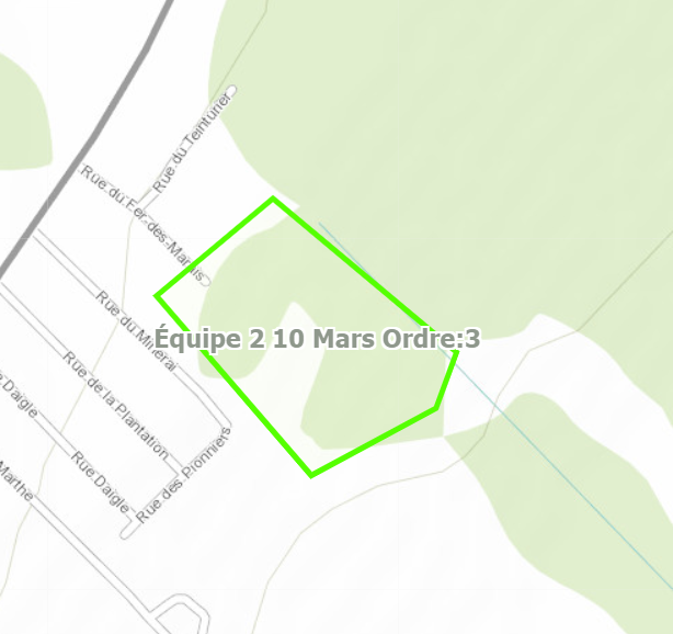

This time, I wanted to create a Multiline label for an Online Feature Class. Indeed, my App will allow user to create and modify features. However, the label is not respected. All the elements appear in one line when it should appear in three.

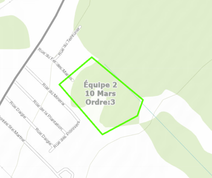

This is how it looks in ArcGIS Pro

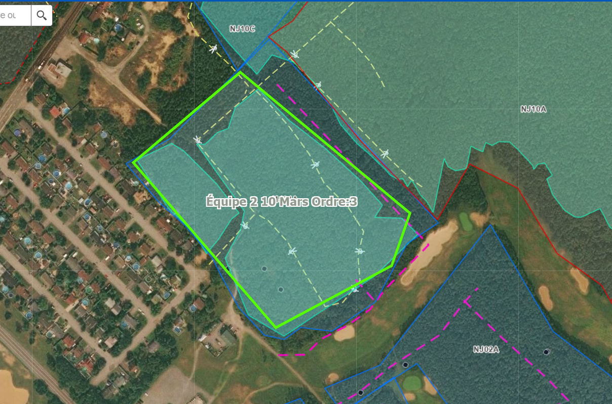

This is how it looks in the Web App:
I am pretty sure that the probleme is the Feature Layer. Obviously, when exporting a Web Layer with a Feature Layer, you are obliged to also export a Web Map Image version. When looking at both in Enterprise through Map Viewer, the Web Map Image version was fine while the Feature Layer version showed the same problem.

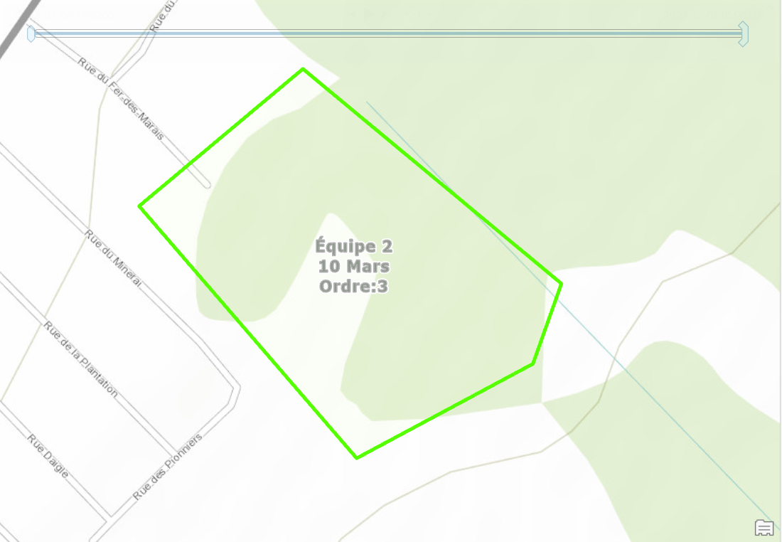

The Web Map Image:
The Feature Layer:
