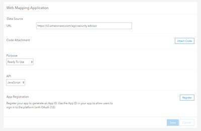

Has anyone seen this?
This is in Chrome and the App Registration is missing.
This is in Edge.  Same Item Same Portal environment.
BUG?

Why yes.  Just a few minutes ago, I ended a support call with one of my Portal users for the exact same problem.  No solution yet.  My environment:  ArcGIS Enterprise 10.8.1 base Windows server 2016 [Server x1 (Federated, Hosting), Portal x1, Data Store x1 (relational)].  All Esri patches applied.
Note:  The user reporting the problem is in a custom Role with most, but not all, publisher permissions.  All our staff users that are Administrator role members can see the app in Chrome.

I am an Admin and it is affecting me.  Chrome version 89.0.4389.114 and Arc Enterprise 10.8.1

Update: This does work for me in the Chrome based MS Edge - v91.0.864.59 (Official build) (64-bit)

I no longer have the issue.  A chrome update fixed it. Current Chrome Version 91.0.4472.124

Interesting. @Anonymous User what version of Chrome are you on that has resolved the issue? I experience the issue in Chrome Version 91.0.4472.106 (Official Build) (64-bit)
