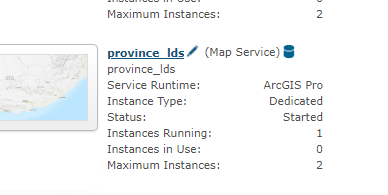

the problem is the services the "mxd and mapx (ArcGIS Pro)" that little database next to your service idicatd the data source so the change will break all you services.
You can run the script below on the server it will write the required metadata into a csv you look for onServerConnectionString if it points to your db then you will need to reconfigure and republish this mxd or mapx service.

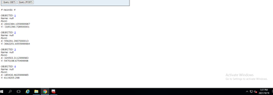

so I created to Microsoft SQL 2016 instances and did the following tests
test service is working

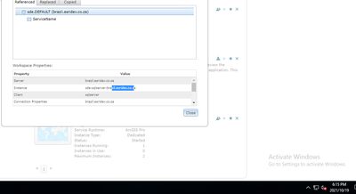

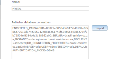

Here you see the old connection

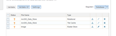

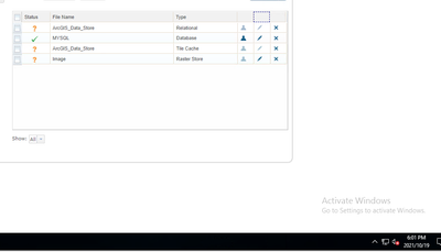

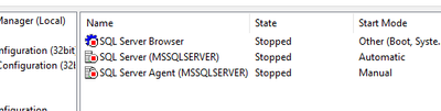

change data source in ArcGIS server shut down the old SQL, tested and the records pulled thru.
Here is the new connection

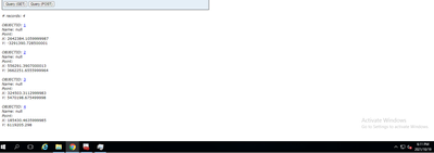

The records are pulling thru
But here is the crux the metadata does not update and you have broken mxd in mapx files in your arcgisinput folder (which if your server crashes is often used to rebuild the services or say you left and the new person needs to work with the data) for example if you work for a large company with a 100 SQL databases and say your datastore connection gets deleted and this is two years down the line with a new GIS Practitioner how will this person fix the problem?
