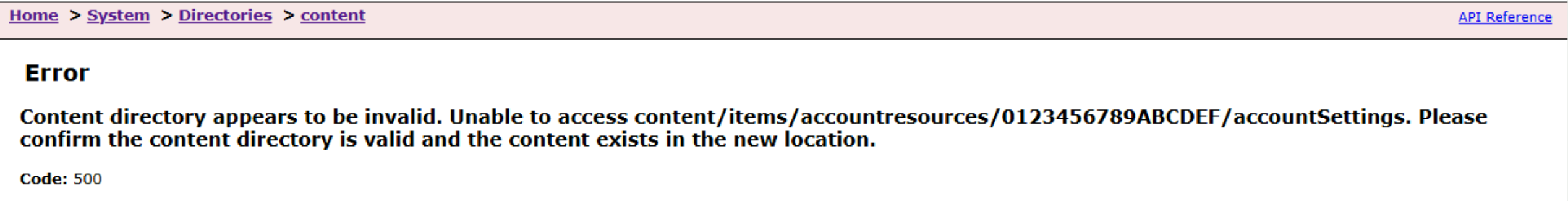

When installing Portal 11.4, it would not let me install the content directory to the file share drive (Z). After installation, I went to portal admin and tried to change it from System > Directories, but I get this error:
which doesn't exist, but that path also doesn't exist in the current directory.

Edit to my original post:
content/items/accountresources/0123456789ABCDEF/accountSettings
Does exist in both places (it's just deep in the middle alphabetically)

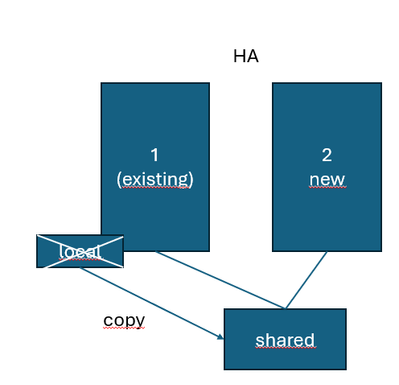

A) Do you expand your existing environment 1 to a HA environment 1+2SimonSchtte_ct_0-1745939088702.png

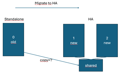

B) or do you migrate to a new HA environment and tried something like this?
Depending on your setup, other workflows need to be used, for example Migrate to a new machine in ArcGIS Enterprise.

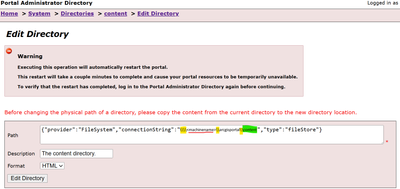

Did you specify the file share as location for the first Portal installation and it failed?
What did you paste into the Edit Directory field?
I have seen the error you get, when \, / or // instead of \\ was used or the \\content was missing.
When entering a shared network location, the connection string syntax is formatted in this way: "connectionString":"\\\\<machinename>\\arcgisportal\\content"
When configuring the Portal and you need to specify the content directory, directory formatting could also block you from using this directory (happened to me before until I noticed / instead of \). [btw. When installing using ArcGIS PowershellDSC it is easy to specify the different storage locations (->ContentDirectoryLocation).]

BillFox
MVP Notable Contributor
yep, these slash things are trial and error
