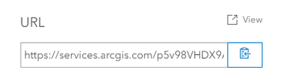

Thank you Jay for posting this! I was able to update it finally using the following steps. I will post it here in case other people run into the same situation.
Click the "view" button next to the URL in the item's overview page --> click "Admin" --> select one of the layer / table --> click "Update Definition" --> replace the maxrecordcount values
Dong_Kun__VDOT_
Some screenshots!
  1. Click "view" next to the URL in the item's overview page.
  1. Click "Admin" (top right corner)
  1. Select one of the layers
  1. Click "Update Definition" (at the very bottom)
  1.  Replace all the Max record count values, and click "update layer definition".
