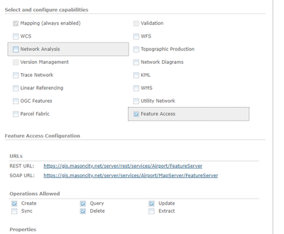

What do your settings look like here? (this is more for survey 123, not referenced layers)
Another place to check is server manger: (this works for my referenced layers)
Did you try map viewer and map viewer classic?

Once you go into server manager click on the pencil icon of the feature layer to go into its settings. Then click on capabilities and then click on feature access and you'll see the operations allowed come up underneath that.
DRae
I checked that it is uncheck. I don't need to enable the feature access before the upgrade, and the map is working fine.

You'd want to make sure query is checked marked and see if that error goes away.
