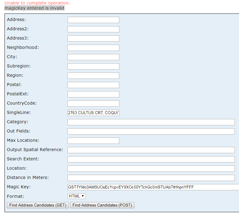

I published a composite locator from arcGIS Pro to ArcGIS server. Everything looks fine except magicKey.
For example, first call sugguestion:
Then call findCandidate:
I just copy the text from suggestion to SingleLine and also copy magicKey as well.
Anybody has same issue before?

Thanks everyone for the feedback.  You have uncovered an issue with composite locators that contain locators created with the Create Locator tool in ArcGIS Pro.  Unfortunately a fix for this issue was did not make it into 10.7.1 but good news is we have created a general patch that fixes this issue as well as a few other issues that were found.  The patch can be found here:

I can replicate this issue with a ArcGIS Pro 2.4 Composite locator published to ArcGIS Server 10.7. MagicKey functionality on 10.3.1 server composite locator returns correct results.

My composite locator was created with ArcGIS Pro 2.3.0 and published to ArcGIS Server 10.7.
I just caught this issue when I tested Portal for ArcGIS 10.7. I set this locator as default locator for Portal, when I entered address in search box on Portal, it listed a bunch of suggestion addresses. But it returned "no location for this address" when I chose one of them.
If I ignore the suggestion and just use Enter after the address, it works. I tracked this request on ArcGIS Server and found the request string is SinglineInput="....."&magicKey="magickey".
So weird!
ArcGIS Server 10.7.1 General Geocoding Patch
At this time the patch is only for 10.7.1.
