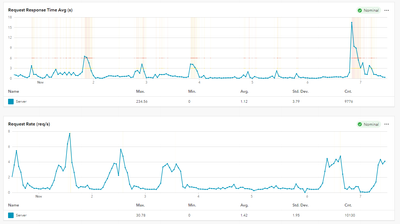

We have been working with our IT network team and, thus far, all of our available tools tell us everything is fine in terms of the server/network load.  We were able to install ArcGIS Monitor (2023.2), which has given us some metrics quantifying how bad the performance gets but we're still unable to identify the cause.  I have attached a graph from Monitor showing the average request response time versus request rate for all services over the past 7 days.
Does anyone have suggestions where to go with this in terms of pinpointing the issue?

There isn't enough of a time window from your graphs to make any specific / meaningful diagnosis;
I'd suggest a 14 (maybe up to 21 day) window and see if there's a pattern (for example, a spike every Tuesday?) and then drill down with more granular graphs (hour resolution) to see if there's a consistent start time for when the utilization spikes are. If there's a consistent start time, that's often a strong indicator of a scheduled system/human process ... if no pattern, pick the worst spike and then pull out all resource consumption (cpu, memory, disk I/O) for a +/- 12 hour window of the spike, related ArcGIS Enterprise component logs and database server logs for the time period.
