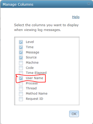

Check if this works.
In ArcGIS Server Manager > Logs > View Logs, click "Column" button. Then enable "User Name" check box.

Antonio_Dang
Thx, that works!

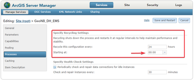

berniejconnors
Antonio,
        the default time for your map services to recycle is at midnight (00:00). We see the same activity on our servers at midnight.  All of the map services are essentially stopping and restarting.  Here are the settings in ArcGIS Server Manager:
Midnight is typically a slow time for our servers so there is no real impact on our users.  You can change the default time for the recycle so not all your services are offline at the same time.
Bernie.
VictorTey
You also possibly want to spread out your recycle time. I have see services (in active HA) locked up before when it could not start up in time due to all the services restarting at the same time. We have a script that "allocate a time slot" when a service has a recycle time of midnight.
