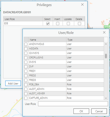

From ArcGIS Pro, you can use the Catalog pane to right-click on a Feature Class you own. Then select Privileges > Add User. That will return a form showing the database users, which might meet your needs.
