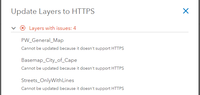

Having an issue with Update Layers to HTTPS in ArcGIS .   So in settings for our webmaps there is the option to Update Layers to HTTPS.  We recently installed a certificate on the server signed by a Trusted Authority in order for our maps to work in all browsers without loading unsafe scripts or mixed content errors.
When I add our HTTPS (6443) layers to webmaps using the Add Layer from Web they work just fine.  However if I use the Update Layers to HTTPS in Settings for the webmap I receive this error.
I'm in the process of changing all of our layer references in webmaps to HTTPS and want to make sure I'm not missing anything.  Will I have to go in to every web map and manually add each layer with is secure REST service address using Add Layer from Web and remove the old ones?

I realized I can Update Site References and replace the http://(server):6080 to be https://(server):6443 and that worked.  I still don't understand why the Update Layers to HTTPS is not working properly.
