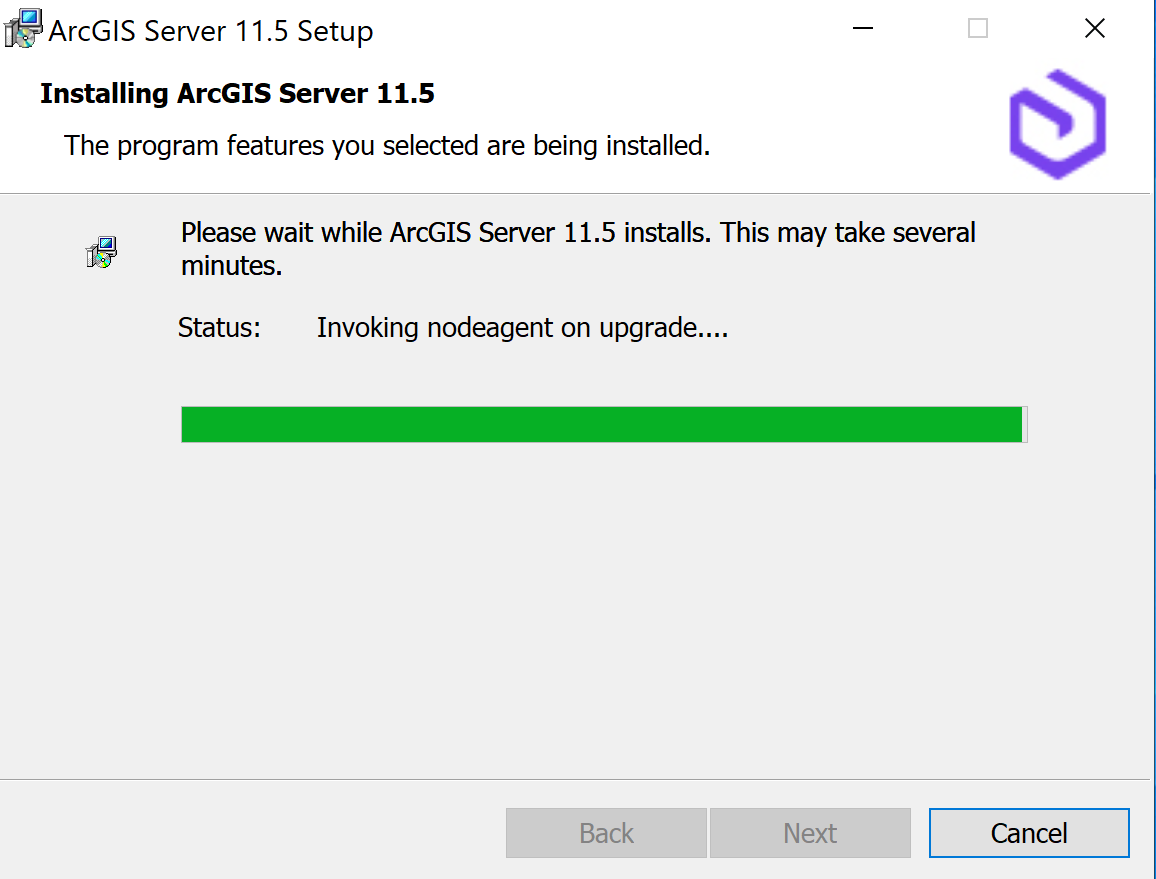

Upgrade of ArcGIS Server was not succesful
I found another post (Solved: Upgrade step 2 of 2 : Failed. Refresh auto-deploye... - Page 2 - Esri Community) that suggested to try another browser. However as ArcGIS Server was completely broken already, we needed to restore the snapshot of the VM. As the Portal upgade was succesful, I decided to only let restore the ArcGIS Server VM. After the restore we had an 11.5 Portal federated with a 11.2 ArcGIS Server. ArcGIS Server directories and the config-store on the fileshare were reverted to the 11.2 files.
Next, I did a second attempt to upgrade the 11.2 ArcGIS Server. But I saw an error in the ArcGIS Sever logs:

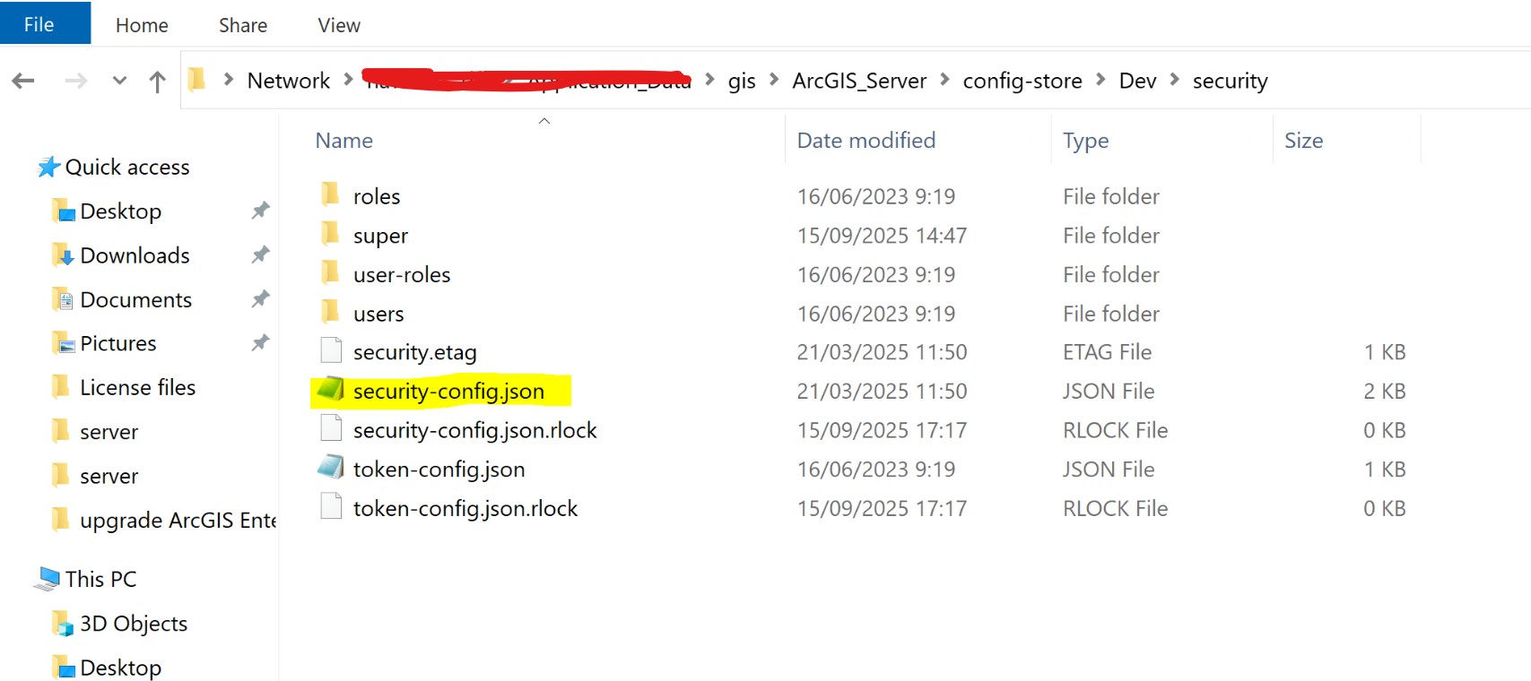

I try to understand what went wrong the 2nd time: error seems to point to the security-config.json, but that file was just present on the fileshare
No idea what the error  (Cannot invoke "com.esri.arcgis.discovery.admin.store.ConfigStore.securityConfigLastModified()" because "this.d" is null</Msg>) tries to say

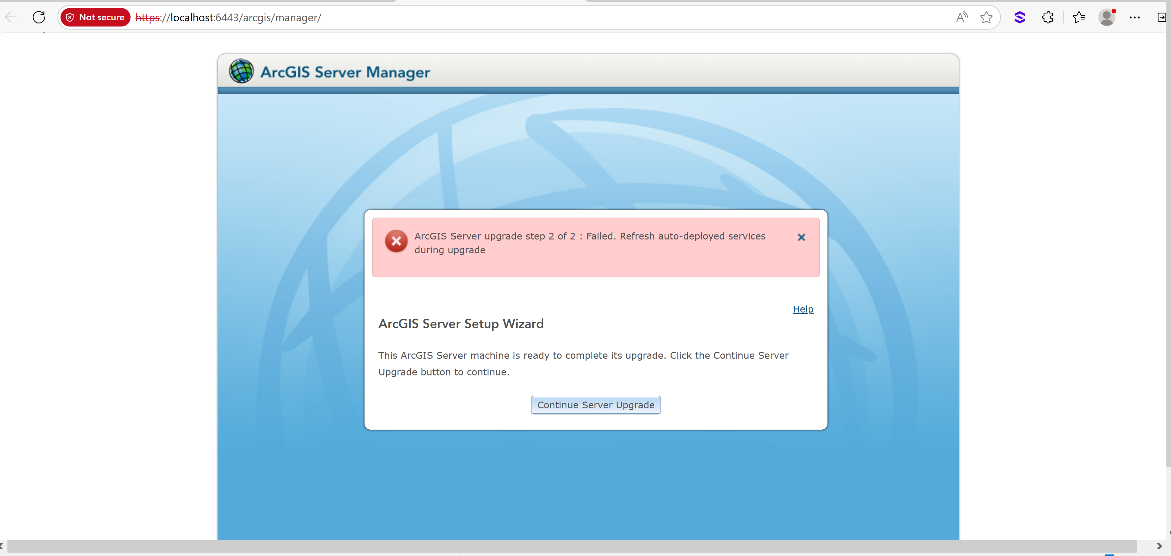

Hi @Scott_Tansley . I couldn't reply earlier. Your workflow described above worked for me. That is : after the successful upgrade of Portal to 11.5 and the failed upgrade of ArcGIS Server to 11.5 the ArcGIS Server was completely broken; after following the procedure you suggested (uninstall ArcGIS Server 11.5, clean install of ArcGIS Server 11.2 and import of the 11.2 agssite file, I had an 11.5 Portal federated with an 11.2 ArcGIS Server. That is the good news. But when upgrading the 11.2 ArcGIS Server directly to 11.5, we see again the same error (Failed to return security configuration. Cannot invoke "com.esri.arcgis.discovery.admin.store.ConfigStore.securityConfigLastModified()" because "this.d" is null</Msg>). The only way to workaround it is to upgrade to ArcGIS Server 11.3. Then no error at all.  Unfortunately, when upgrading beyond 11.3, then we still have the other error (Upgrade step 2 of 2 : Failed. Refresh auto-deployed services during upgrade). Esri inc support has no clue about both issues yet . (The step with upgrading to 11.3 was our own idea). So now we have an 11.5 Portal federated with an 11.3 ArcGIS Server with a registered 11.2 relational Datastore and an 11.2 tile cache Datastore. But as we can get rid of the first error, fine for me to upgrade ArcGIS Server first to 11.3 before proceeding to 11.5. Hopefully Esri inc finds a solution for the 2nd issue
