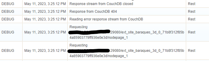

But validation of the datastores from ArcGIS Server Manager or ArcGIS Server admin interface is successful. Webgisdr log say it successful as well.
On ArcGIS Server Manager in debug mode, this 500 errors seems to be related to 404 from CouchDB:
This issue occurs on both ArcGIS Enterprise deployments we are running. The procedure to restore on standby is implemented since several versions and we never faced any issue (except at 11.0 with restoring relational datastore cf. https://community.esri.com/t5/high-availability-and-disaster-recovery-questions/cannot-restore-arcgi... that was fixed later with a patch).

	at com.esri.arcgis.datastore.client.DataStoreAdminClient.configCouchDB(DataStoreAdminClient.java:13915)
	at com.esri.arcgis.datastore.client.DataStoreAdminClient.a(DataStoreAdminClient.java:12721)
	at com.esri.arcgis.datastore.client.DataStoreAdminClient.deployWebGISSnapshot(DataStoreAdminClient.java:11789)
	at com.esri.arcgis.datastore.client.DataStoreAdminClient$e.run(DataStoreAdminClient$e.java:10924)
	at java.base/java.lang.Thread.run(Unknown Source)
</Msg>
<Msg time="2023-11-07T23:57:39,101" type="DEBUG" code="9999" source="Data Store" process="9940" thread="25" methodName="" machine="MAPS11.COMPANY.COM" user="" elapsed="" requestID="">Register new title cache data store...</Msg>
<Msg time="2023-11-07T23:57:47,820" type="DEBUG" code="9999" source="Data Store" process="9940" thread="25" methodName="" machine="MAPS11.COMPANY.COM" user="" elapsed="" requestID="">Register a default backup location for tile cache data store...</Msg>
<Msg time="2023-11-07T23:57:47,820" type="DEBUG" code="9999" source="Data Store" process="9940" thread="25" methodName="" machine="MAPS11.COMPANY.COM" user="" elapsed="" requestID="">New Backup Location will be: E:/backup/tileCache/</Msg>
<Msg time="2023-11-07T23:57:47,820" type="DEBUG" code="9999" source="Data Store" process="9940" thread="25" methodName="" machine="MAPS11.COMPANY.COM" user="" elapsed="" requestID="">creating backup store for tile cache data store....</Msg>
<Msg time="2023-11-07T23:57:47,833" type="DEBUG" code="9999" source="Data Store" process="9940" thread="25" methodName="" machine="MAPS11.COMPANY.COM" user="" elapsed="" requestID="">prepare file based repository provider for tile cache data store...</Msg>
<Msg time="2023-11-07T23:57:47,834" type="DEBUG" code="9999" source="Data Store" process="9940" thread="25" methodName="" machine="MAPS11.COMPANY.COM" user="" elapsed="" requestID="">prepare file based repository provider for tile cache data store on local machine...</Msg>
<Msg time="2023-11-07T23:57:47,868" type="DEBUG" code="9999" source="Data Store" process="9940" thread="25" methodName="" machine="MAPS11.COMPANY.COM" user="" elapsed="" requestID="">configuring repository for  the  backup store...</Msg>
<Msg time="2023-11-07T23:57:47,893" type="DEBUG" code="9999" source="Data Store" process="9940" thread="25" methodName="" machine="MAPS11.COMPANY.COM" user="" elapsed="" requestID="">Digital sign the backup store...</Msg>
<Msg time="2023-11-07T23:57:48,253" type="DEBUG" code="9999" source="Data Store" process="9940" thread="25" methodName="" machine="MAPS11.COMPANY.COM" user="" elapsed="" requestID="">prepare for tile cache data store configuration...</Msg>
<Msg time="2023-11-07T23:57:48,254" type="DEBUG" code="9999" source="Data Store" process="9940" thread="25" methodName="" machine="MAPS11.COMPANY.COM" user="" elapsed="" requestID="">Configure vm.args...</Msg>
<Msg time="2023-11-07T23:57:48,257" type="DEBUG" code="9999" source="Data Store" process="9940" thread="25" methodName="" machine="MAPS11.COMPANY.COM" user="" elapsed="" requestID="">Prepare default.ini...</Msg>
<Msg time="2023-11-07T23:57:48,259" type="DEBUG" code="9999" source="Data Store" process="9940" thread="25" methodName="" machine="MAPS11.COMPANY.COM" user="" elapsed="" requestID="">Prepare SSL certificates...</Msg>
<Msg time="2023-11-07T23:57:48,478" type="DEBUG" code="9999" source="Data Store" process="9940" thread="25" methodName="" machine="MAPS11.COMPANY.COM" user="" elapsed="" requestID="">Configure C:\arcgisdatastore\staging\tileCache\tcs_dyv65252\etc\local.ini...</Msg>
<Msg time="2023-11-07T23:58:05,243" type="DEBUG" code="110616" source="Data Store" process="9940" thread="25" methodName="" machine="MAPS11.COMPANY.COM" user="" elapsed="" requestID="">Webhooks database for site 'd3e74a59-4154-43a2-a5a9-cc0f5dcfdf4b' is not created and registered.</Msg>
<Msg time="2023-11-07T23:58:50,951" type="SEVERE" code="111002" source="Data Store" process="9940" thread="25" methodName="" machine="MAPS11.COMPANY.COM" user="" elapsed="" requestID="">Failed to import data to your replicated site. null</Msg>
<Msg time="2023-11-07T23:58:50,951" type="DEBUG" code="9999" source="Data Store" process="9940" thread="25" methodName="" machine="MAPS11.COMPANY.COM" user="" elapsed="" requestID="">com.esri.arcgis.datastore.common.DataStoreException
	at com.esri.arcgis.datastore.model.couchdb.CouchDBManager.restore(CouchDBManager.java:8270)
	at com.esri.arcgis.datastore.client.DataStoreAdminClient.a(DataStoreAdminClient.java:12934)
</Msg>
<Msg time="2023-11-07T23:58:50,952" type="DEBUG" code="9999" source="Data Store" process="9940" thread="25" methodName="" machine="MAPS11.COMPANY.COM" user="" elapsed="" requestID="">Stopping nonsql database </Msg>
<Msg time="2023-11-07T23:58:50,954" type="DEBUG" code="9999" source="Data Store" process="9940" thread="25" methodName="" machine="MAPS11.COMPANY.COM" user="" elapsed="" requestID="">NoSQL database was stopped </Msg>
<Msg time="2023-11-07T23:58:53,161" type="WARNING" code="110804" source="Data Store" process="9940" thread="25" methodName="" machine="MAPS11.COMPANY.COM" user="" elapsed="" requestID="">Failed to register tile cache data store. The specified GIS Server site already has a tile cache data store.</Msg>
<Msg time="2023-11-07T23:58:53,161" type="DEBUG" code="9999" source="Data Store" process="9940" thread="25" methodName="" machine="MAPS11.COMPANY.COM" user="" elapsed="" requestID="">com.esri.arcgis.datastore.common.DataStoreException: The specified GIS Server site already has a tile cache data store.
	at com.esri.arcgis.datastore.model.couchdb.CouchDBManager.registerDataStore(CouchDBManager.java:661)
	at com.esri.arcgis.datastore.client.DataStoreAdminClient.registerTileCacheDataStore(DataStoreAdminClient.java:13937)
	at com.esri.arcgis.datastore.client.DataStoreAdminClientForServer.registerDataStore(DataStoreAdminClientForServer.java:2856)
	at com.esri.arcgis.datastore.client.DataStoreAdminClientForServer.registerDataStore(DataStoreAdminClientForServer.java:2757)
	at com.esri.arcgis.datastore.client.DataStoreAdminClient.a(DataStoreAdminClient.java:13044)
</Msg>
In couch log, no error though.
