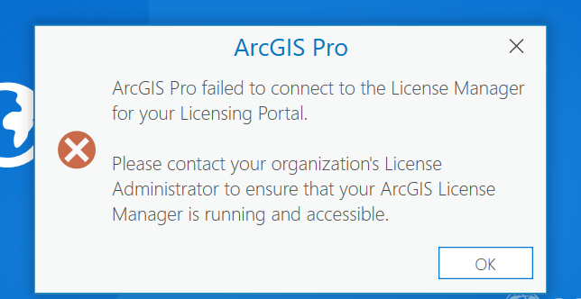

Dear Community
I am trying to install ArcGIS Enterprise along with ArcGIS Pro, so I have created a license file(.json) from MyESRI and have configured it with ArcGIS Portal. I can see ArcGIS Pro licenses in there. I have also installed the License Manager and have authorized it with the same license file. I can see Licenses in the Availability tab there as well. I have cross checked the License Manager hostname in the portaladmin and it is correct along with port number as 27000. Both Portal and License manager are on same machine. Now when I am trying to access and authenticate ArcGIS Pro (which is on diff machine) from Portal. It gives me the following error:

AmnoyAm
You're almost there.  The license manager uses two ports for two separate vendor daemons.  Port 27000 is the default port for the lmgrd.exe daemon.  you must define another open port for the ArcGIS.exe vendor daemon.  After doing so, both ports must be open through the firewall(s).  Refer to the following documentation for additional information:  https://desktop.arcgis.com/en/license-manager/latest/configure-the-arcgis-license-manager-to-work-th...

DeepikaJain01
Thank you everyone for the help, that was the exact issue. I had to define another for ArcGIS Vendor and then define open it through the firewall through Inbound rules. ArGIS Pro opens up like a charm..Phew....:)

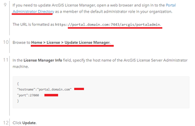

GrantSmith122
Hi, thanks for this solution. Once this is configured, do you have to update anything in the 'Update License Manager' section of the Portal Admin Directory? Currently mine is just set to:
"hostname": "host domain",
"port": 27000
do you have to specify the new port information here?
AmnoyAm
Keep in mind these are information provided to ArcGIS Pro from the portal's response.  It's telling Pro to go to that hostname for the license manger and use this port.  That is all that is necessary here.  Pro will then make a call to the license manager server by the name you provided, whether its the hostname, FQDN, etc.  Make sure this name is accessible from the Pro machine.  Also as part of the license manager configuration, you had to specify an open port for the arcgis.exe vendor daemon.  Pro will communicate to the license manager using ports 27000 for lmgrd.exe and the "open port" you configured.  These ports must be open between the Pro machine and license manager server.  Portal is no longer needed at this point.
Perhaps an overkill but hope that clarifies any confusion.
