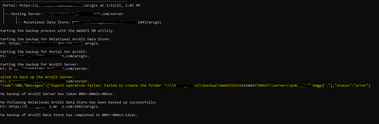

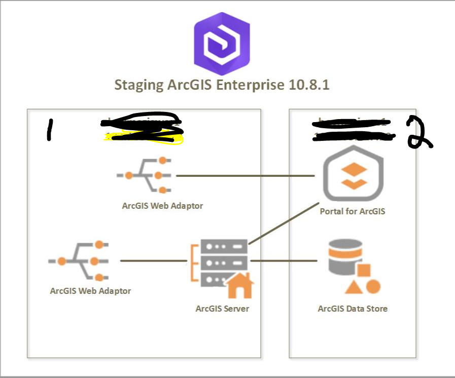

I'm facing issue while exporting full site using WebGISDR tool for multi-machine deployment.
The bellow figures illustrating our deployment and the error:
the account "arcgis" has W/R permissions for the Shared_Location
Spoiler
Failed to back up the ArcGIS Server:
Url: XXX/server.
{"code":500,"messages":["Export operation failed. Failed to create the folder '\\\\xxxxx\\backup\\WebGISSite1610447768427\\server\\xxxxxxxx'."],"status":"error"}
