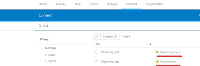

Kindly excuse me if I was not clear enough. If we look at the below example:
This service has edit access enabled and has its associated Map Image and Feature service:
In our case we published this from ArcGIS Pro with Pop-ups disabled, but in Portal they shows pop-ups, which for a Feature Service we can expect.
