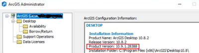

As suggested in the above link, you should install ArcGIS Desktop 10.8.2 (latest) version, since internally, the product version is 10.9.1
