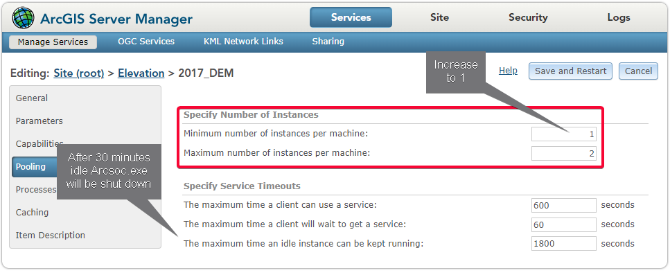

berniejconnors
Hello,
        If this only happens the first time the services are accessed each morning the problem could be that all of the services have zero instances running and the server cannot activate an instance before the timeout expires. What are the min and max instance setting for each service?  How many Arcsoc.exe are running in Task Manager early in the morning?
If all your min instances are set to zero that could be your problem. Try setting min instances to 1 for the most popular services.
All idle services will be shut down after 30 minutes (1800 seconds) with the default publishing settings for an image service.

I would not recommend publishing all of your image services as shared instances.  You should evaluate your services to determine which ones are used most frequently.  Those services should use a dedicated instance.  The services that are used infrequently can use a shared instance.

AngusHooper1
Ditto. Common feedback and best practice is to not use shared instances for imagery services.
Also, you may want to look into how ArcGIS Server is accessing the underlying data at a protocol level (e.g. SMB). If this issue is occurring daily then there may be a session timeout/cache issue.
