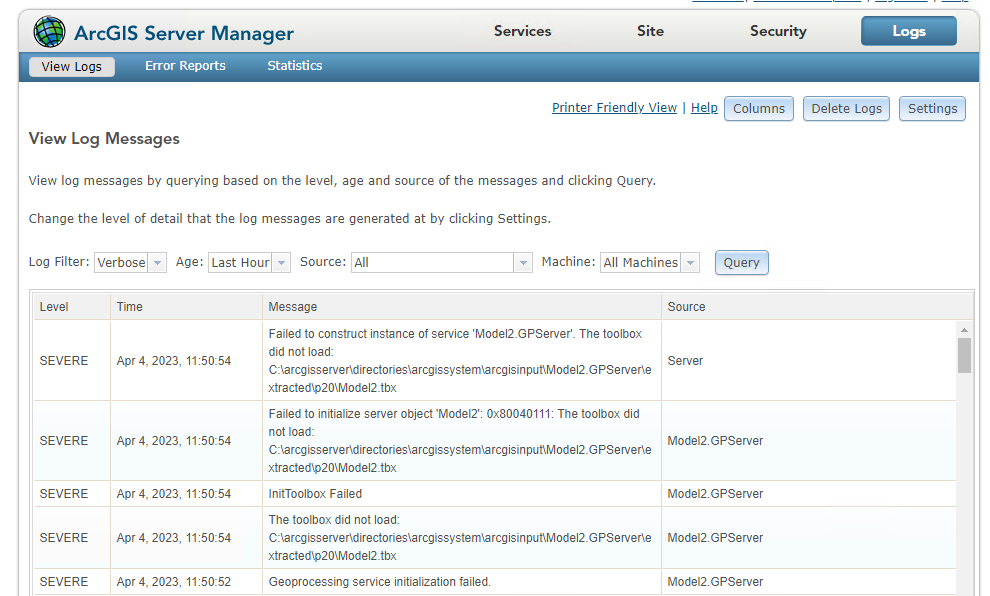

wizgis
Thank you for your inputs @Omar_A. I went through all of the above mentioned points however, still running into the issue.
I also created a simple model with just one tool and published that as GP service however, I am still facing the same issue.
I see the following error in the log.
