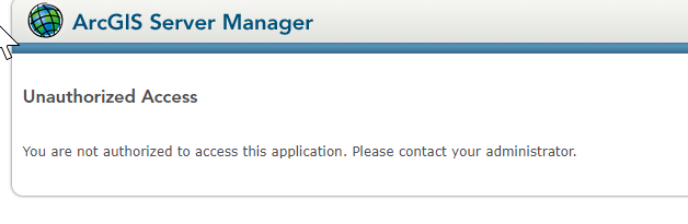

If I try https://gisserver.domain.com:6443/arcgis/manager, I get the following notification:

It sounds as though you are encountering a known defect: "BUG-000116672: Trying to register a database with a federated ArcGIS Server 10.6.1, configured with Integrated Windows Authentication (IWA), redirects to the login screen in ArcGIS Server Manager."  You can subscribe to this defect here; doing so can help us understand the demand behind this bug.  As a workaround, you can use ArcGIS Desktop to register the database or manually registered the database at REST.
