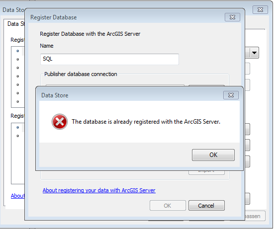

However when I register the datasource it says that it already has this connection:
Performance is orders of magnitude slower, don't know if this is the most concise way to get a connection to an SDE. Any thoughts?
