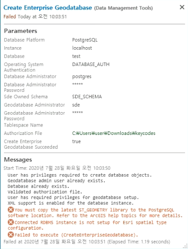

Hi,
I am using ArcGIS Enterprise 10.7 installed on Linux(CentOS7) and Pro 2.4.3 installed on Windows.
To test Enterprise Geodatabase locally, I installed PostgreSQL 9.6.12 on my windows.

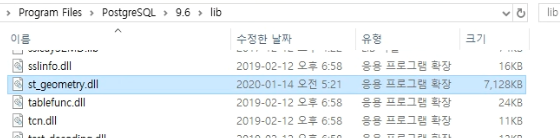

And then copied st_geometry from database support file to Postgres/lib folder as below.
"Create Enterprise Geodatabase" complains about ST_GEOMETRY.
Any suggestions please??
