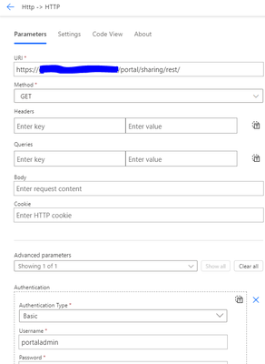

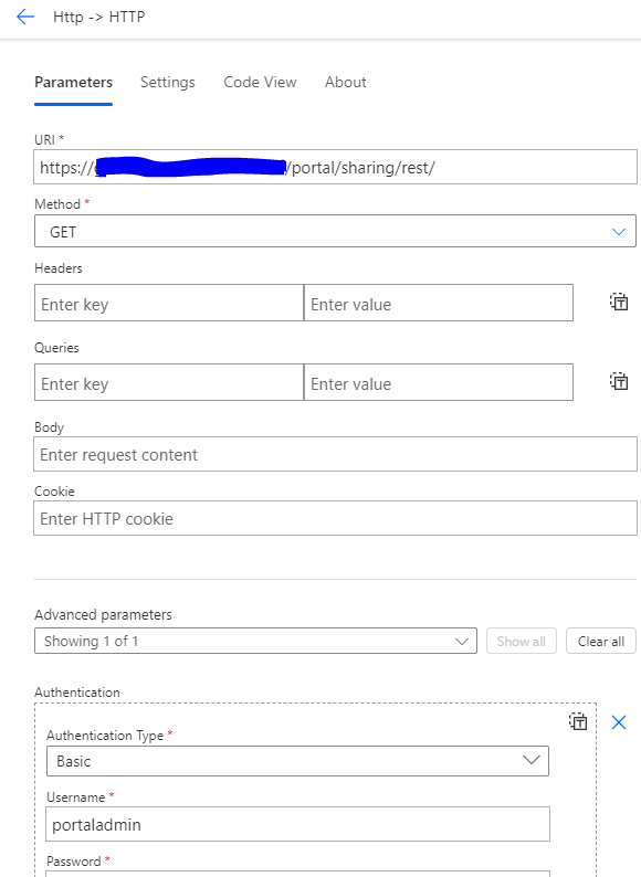

I've configured the webhook in ArcGIS Enterprise succesfully, but I'm struggling now in PowerAutomate with the authentication against /portal/sharing/rest
I tried to authenticate by setting Authentication Type to Basic and providing the portaladmin credentials

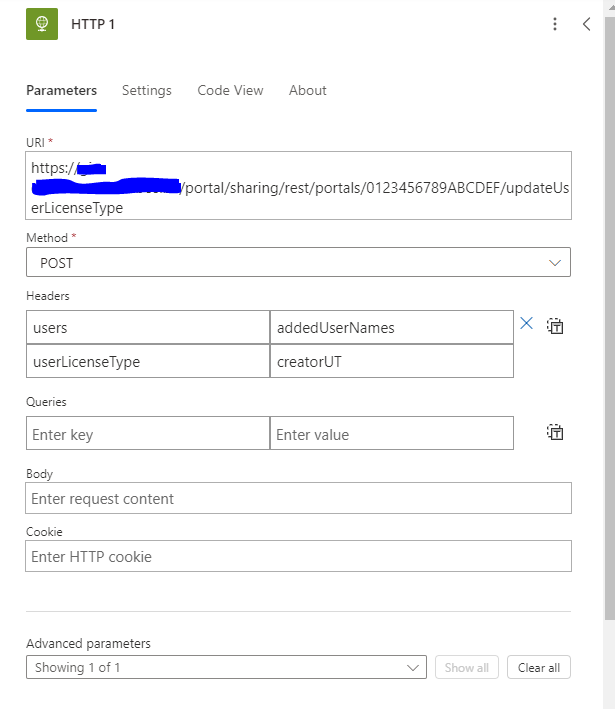

Next, I execute the http POST request as follows:
But this doesn't seem to work
The webhook receiver is triggered succesfully when a user is added to the group, but it seems that the authentication goes wrong against /portal/sharing/rest, because I receive a 403 error: "You do not have permissions to access this resource or perform this operation"
So basically my question is, how do you authenticate agains /portal/sharing/rest so that you can execute all the available POST requests
I'm not a developer, but I hope that this should be possible in some way? All ideas or sample code are welcome (preferably in Power Automate)

I'm not real sure what thing in Power Automate your first screen shot is from, but I'll guess it's not what you want to use / it doesn't authenticate like you want.
Try making an HTTP Post call to generateToken: https://developers.arcgis.com/rest/users-groups-and-items/generate-token/
That should return a token, which you can then use on all your calls that require authentication. In my screen shot I get a token, parse it from the response, and make use of as a header on all my calls back to the Portal.
