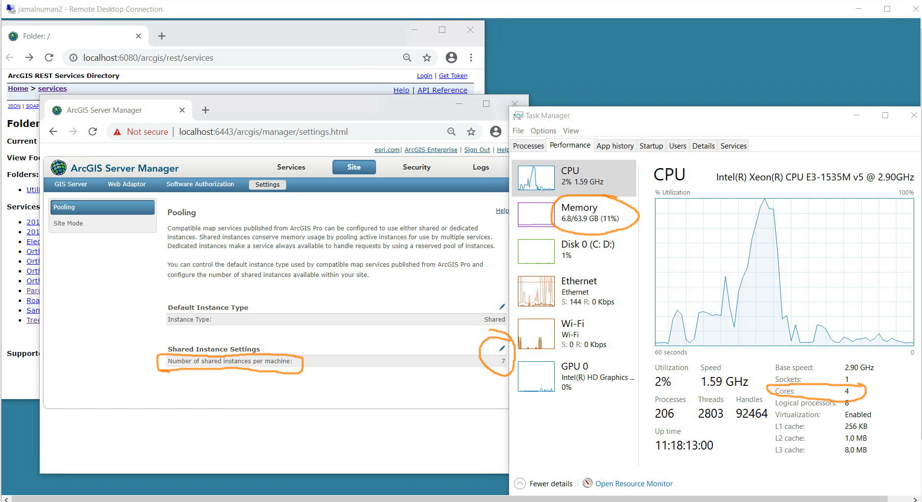

I thought that there should be direct association between the load (map services) and machine resources (cores/ram)

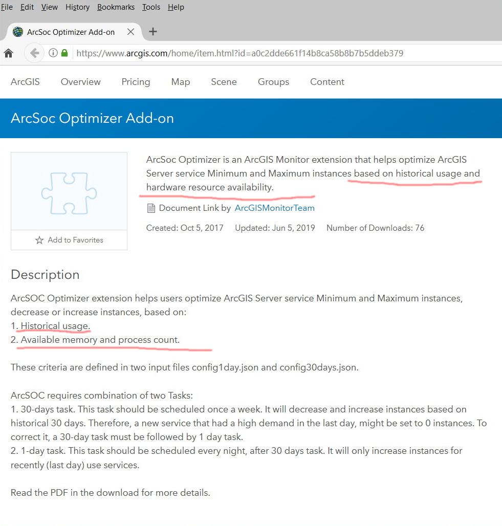

Thanks Ahmad. We will be considering the “ArcSoc Optimizer Add-on” and find out if it brings a good tool to design the best fit between the load and resources. However, this tool is very costly as I got.
Thanks Jonathan. We will be configuring the Registry Editor as it is recommended. We will provide our feedback. We need also to better explore the concept of the “shared instances” of the 10.7
Thanks Thomas. I’m still wondering how the total number of ArcSoc.exe assigned for min\max for all services in a machine is not related to the recourse. Does a machine of 4 cores works the same as a machine of 32 cores?

Assuming no load or requests are making it to the Server, the number of services you can publish to a 4 core and 32 core machine should be the same as long as the machines have the same amount of RAM. There's a bit of internal overhead for managing services and more cores will handle that better, but in general, it should be roughly the same.
Once the machine starts taking requests, you'll need to monitor the usage and resources and make adjustments as necessary.

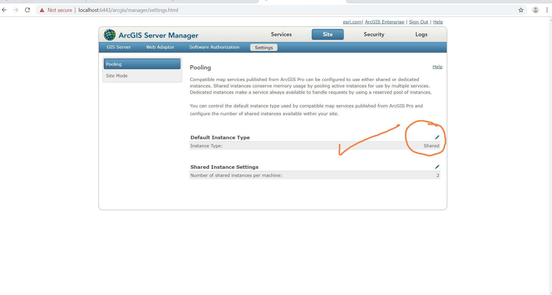

I think you can change the behavior by
  1. Browse to Site > Settings. You'll access these settings from the Pooling page.
  2. To change the default instance type for compatible map services, click the edit button for Default Instance Type. Select the instance type you want to have be the default setting:
    • Select Dedicated instances if you anticipate that most of your services will receive frequent traffic, or if you will not have enough services running in your server site to present a significant load on machine memory.
    • Select Shared instances if you publish many services that only receive infrequent requests, or if you are concerned about additional services being published that will strain your memory resources.
https://enterprise.arcgis.com/en/server/latest/administer/windows/configure-service-instance-setting...

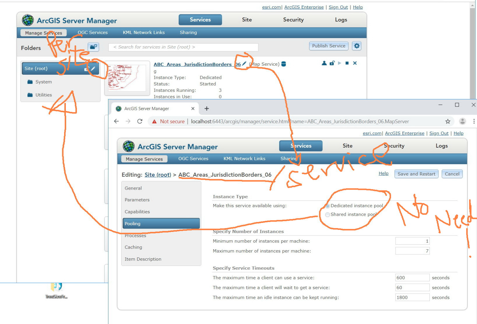

MajdoleenO_A__Awadallah
Thank you Ahmad for your reply, do you mean that changing the default instance type per site to “shared instances” will affect all the services, and all the services will share the number of instances? and in this case we don’t need to apply the pooling setting per services as shown below.
