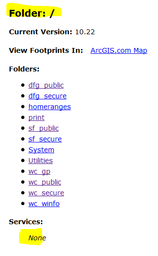

I actually have folders for the public/unsecure services too, and don't publish anything to the root.  This way you can control the public services easier too, if you need turn off public access for a while.  I create a _public and a _secure for each Division/project.

All my folders are under the root, I just don't put anything directly into the root.  This is my structure (when I am logged in so I can see my secure folders too).  Notice that I am looking at the root in the clip, and no services are listed.  I hope that clarifies it a bit.
That is how I decided to set it up and at least so far at least, it has been working for us.
