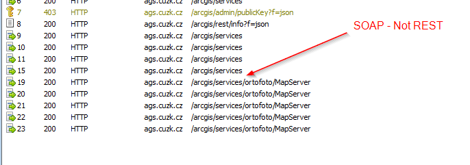

Showing a browser url does not signify that Rest is what was used, it only shows you the structure that exists via REST, in a browser and that the service is up and running..  REST in a browser is easily legible where as SOAP is not... but I will show you regardless.
I will use Fiddler, which will monitor the HTTP Traffic... This directly shows what ArcMap is doing. (A broswer is not tied to ArcMap thus irrelevant.)
When I type in the same URL you are using... ags.cuzk.cz/arcgis/rest/services into arcmap and add a layer...
You will see the initial REST, only because that is what was typed in... but then you will notice it changes to SOAP, and further, I added your ortofoto mapserver as a layer in ArcMap and it is SOAP as seen in Fiddler, there is no REST anywhere.
If you want to see that in a broswer it would be this:
http://ags.cuzk.cz/arcgis/services/ortofoto/MapServer?wsdl - This is what ArcMap Reads to obtain MapServer.
Here is that layers source in ArcMap... showing I had typed in /rest/  (oops meant to highlight the Rest part) but you get the idea.
In various samples in ESRI Documentation this is also mentioned.
ags.cuzk.cz/arcgis/rest/services - REST Service  AND   http://ags.cuzk.cz/arcgis/services?wsdl  - SOAP Service
Use these to look via Browsers.
Another way to show would be to go to your server and block any outbound SOAP traffic (URL Writer or something) and left the REST calls as is.. ArcMap would not work.
I hope this makes better sense.
