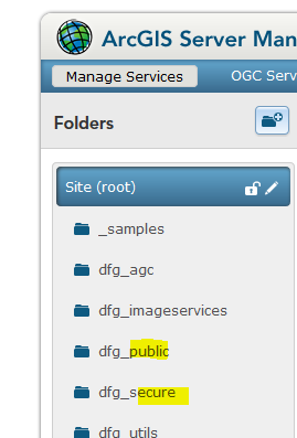

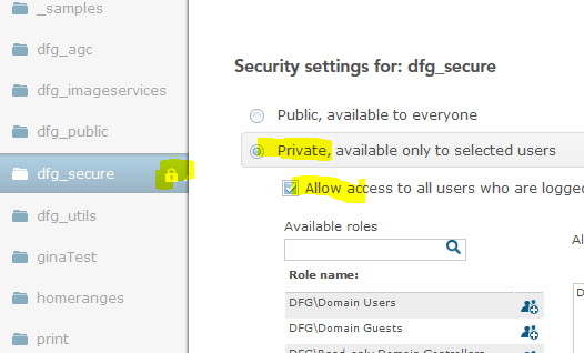

Do you have a subfolder structure on you server...how I separate them is creating folders and setting the security on the folder.  You want to make sure that the "root" directory is public however, or it will block everything.  for example
   name them in a way that makes sense for your situation....StateA, StateB, etc.
Then depending how you have your security setup (we use Windows Domain active directory), you can set the folder to private and only allow certain groups to each folder
The trick is getting the users/groups/roles in a way you need.  Then, looking at the REST directory, only those fully public will show, all else will need to log in and they will see what they have been granted.  Keep in mind you will want SSL if they are login in over the web...and using in web apps etc may get you into needing proxies/tokens.
