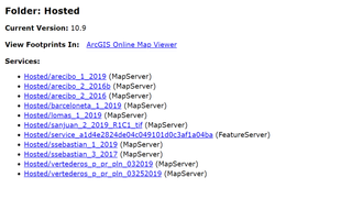

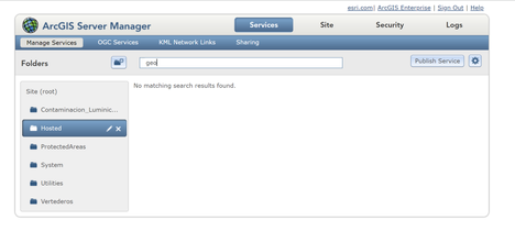

When I go to arcgis catalog I just see some services, not all, and the same happen in rest endpoint and server manager logged with portal administrator user.
hosted server in cataloghosted server in catalogrest endpointrest endpoint
manager hosted servicesmanager hosted services

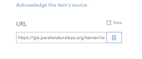

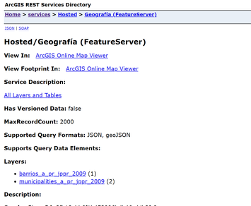

But when I am logged to portal and I consume the hosted services missing in all those places, I can use them with not problem with portal administrator user. from Geografia item i click view rest endpoint from the service, I can the the service
Item in portalItem in portal
geografia rest endpointgeografia rest endpoint

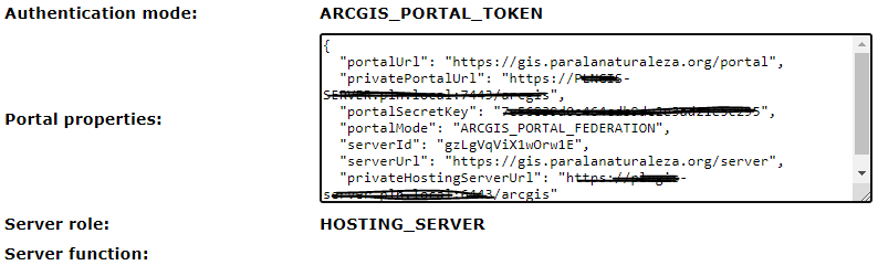

I was able to get the hosted. I was missing my full name of the server in portal properties in server/admin,
Once I used https://machinename.domain.com:7443 it worked, because for some reason the Url changed to https://machinename:7443. Once the URL was used full name, it worked.
