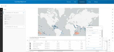

You could try to go to the Item Details Page of the web service and open the visualization tab. Then open the attribute table and click the settings symbol. There you can set visibility of the fields. When you have made your changes save them and it will become the default settings for your layer.
