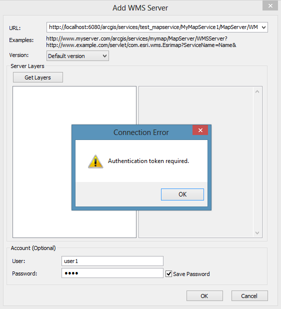

i'm a gis beginner. i create wms service. and i set user & role to accessible. (user1)
when i open wms in arc map it's error "authentication token required"
error authen
i try read help document. use token
http://localhost:6080/arcgis/services/test_mapservice/MyMapService1/MapServer/WMSServer?token= 6o3bne5bR72Rix3emqUZm7jw8B9g4x4wzYXglgdsn4HzEUGtYOISvHib3ZpzBKgThtKtl_ormeoSU9VBfHM8QK-rNlR5BHSz2xTjdLUpKKETA2YN6ooP6rZW94fFT0CgIyiDG3e5CnFqzLfsxoMX-wWH0jm4VctU6M7XbKX9gmU.
but it's still error (can't access  wms) how to remove token authentication.

Dan, I think that parameter/option was added in version 10.4, according to the help.  Based on the poster's image, they are using an earlier version.

thank you all for try help me, i use arcgis server 10.3 & arcmap 10.3.
if i unlock security setting in arcgisserver.  everyone can access service.
unlock
access ok
but i want geotransport group can access wms only. how to fix it. sorry my english is not good.

what about private, only to selected users... seems to be the only option for the version of software you are using
supermanbatman
Deactivated User
if i choose private and select geotransport group. arcmap can't open wms "
 it's error "authentication token required" As Top image

This seems to be a know limit described in bug: Bug NIM089583.
Vladimir
RandallWilliams
You can get a token from the GIS Server and append it to the end of your WMS URL, and not pass username/password. The issue is related to how ArcMap expects to access OGC - there's no provision in the OGC spec for Esri tokens, but there is for basic/digest auth (web tier authentication).
