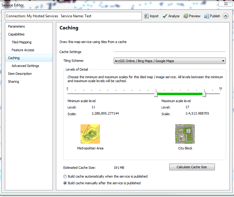

I think you are on the right track as far as what you are thinking.  If you want to be able to edit through desktop you will edit the database directly through a database connection and ArcGIS online the best solution for you would be hosting your own service and re-direct this out through ArcGIS online as a feature service in some sort of web map that you want to create for editing.   This way all of the data is stored locally and updates automatically show up at all points.  The other option would be to publish everything to AGO turning on feature access and Map Tile for the service this way you will have a map service and feature service.  The only problem with this is your Desktop edits will be downloading from AGO and then you will push back out which is not as dynamic as the locally hosted server.  Remember to shut off cache automatically!!!!!!!
