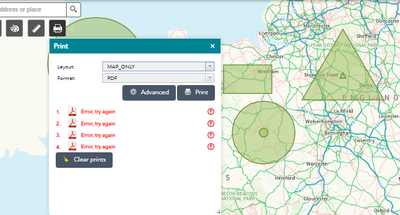

We are potentially experiencing a similar issue in Enterprise 10.9. When using the draw widget circle, square or triangle tool - it draws a small concentric shape in the middle. Then when we try to use the Print widget, there is an error trying to print.
