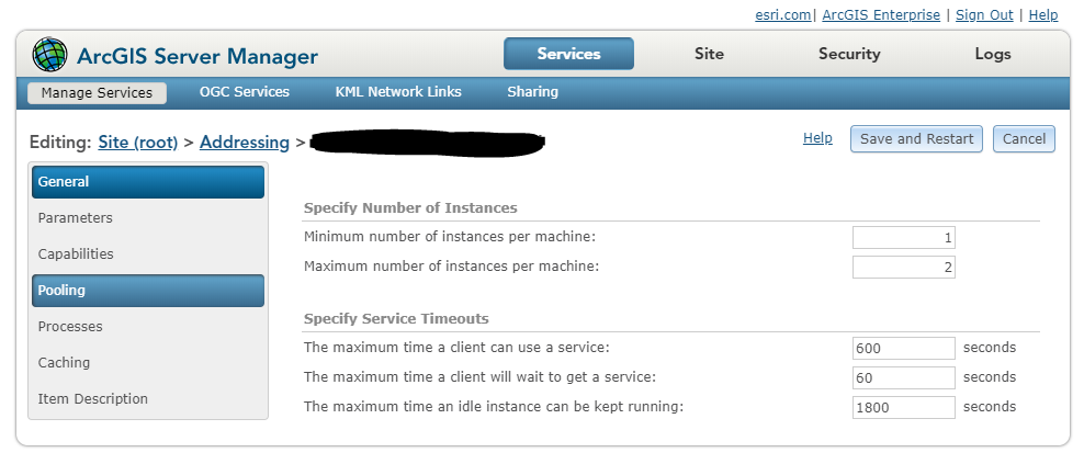

I'd recommend going to your server manager and checking the pooling timeout allowance. By default, geodata services come with the timeouts listed in the screenshot below, but maybe you need to increase them in your case? Just an idea.
It could also be that you need more instances to be available at any given time.
