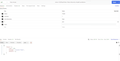

Thank you for the response! It was very straightforward so I appreciate that, I attempted to create the token and use it in the same way I had before using a GET request, and it now states Invalid Token. I attempted this with IP Address and IP Address of this request's origin.

If you use a token generated by the PSA does that work to edit on the layer? If so you may want to login in a different browser with the user credentials created and used to generate the token and check whether you can edit the feature layer in question.

Thank you for the quick response, I attempted with the Portal PSA and it remained the same, I attempted with the Server PSA as well and got Invalid Username or Password on the token generation, I assume due to it being a Server account not a Portal account. I was able to edit on both PSA and account tested, very unusual stuff!
