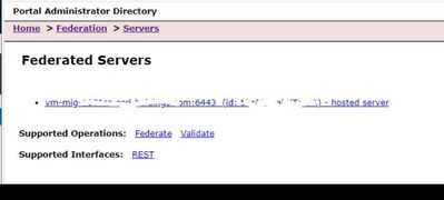

If you login to Portaladmin directory, and then go to Home > Federation > Servers  you should see the server that is federated with the Portal. and whether it is the hosting server:
If it is showing "hosted server" as above, then the server is federated and is the hosting server.
