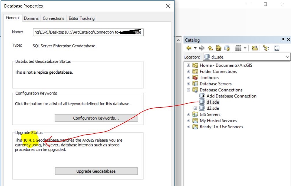

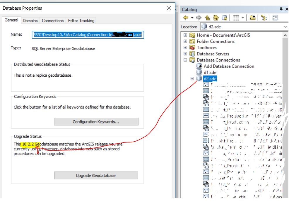

I have 2 enterprise databases which were working fine on 10.4.1, after upgrading to 10.5.1. All features inside one of the databases “d1” disappeared the version of this database is 10.4.1, the other database "d2" works fine after upgrade  the version of this database is 10.2.2.
Knowing that the two databases are working fine form another machine that runs 10.4.1 desktop with the same user name and password which eliminates any permissions or privileges issues!
Have any one experienced this issue before? What might be the issue here?

I have downloaded ArcGIS for Desktop patch but the issue still there!
After the new patch installed the sde user is now able to view the data form the catalog but the windows authenticated user can't view the data. So I would presume that the patch didn't solve the whole issue!
