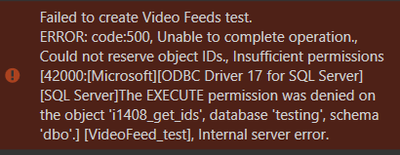

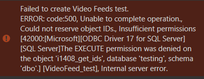

I created a branch versioned feature service with version management checked.  I then brought the feature service into ArcGIS Pro, created a named version and switched to that.  I could update and save attributes, but when I click on the map to create a new feature, the Create Feature tool pops up this error message:
When I check the ArcGIS Server Manager logs, it shows:

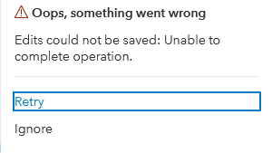

Decided to try editing in a web map from Portal.  I could update attributes in Default (I haven't figured out how to create a version for use in a web map, yet. One step at a time 🙂 ), but when I tried to  save a new feature, the following would pop up (no more helpful than those 99999 error codes):

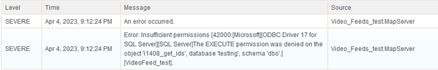

The Server Manager logs showed the following:
Where does the problem lie?

As Scott suggested, it was a permissions problem, although the Server account already had the role of db datareader and db datawriter.  My DBA preferred to not assign permissions at the individual database level, since all the databases on this instance are intended to work with the ArcGIS server, so he gave it the db owner role, as well.  That solved my problem.

It looks like the ArcGIS Server only has read-only permissons to the SQL Server?  Are you using IWA or SQL users for the connection?  Can you confirm that one or the other has edit permissions in the database?

We are using IWA.  I have sysadmin on the overall SQL instance but nothing specified at the database level.  The ArcGIS Server account has Connect perms with DBO to the database.  I  am guessing the Server account is needing explicit permission to Execute?  Any other permission that should be made explicit for branch-versioned editing?
