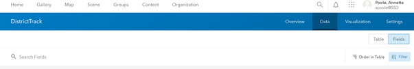

Hello,
I unlocked the schema and it didn't work for my purposes.  And actually I can edit the data in the attribute table.  But I can't edit the data, under items details.  I want to edit it here because I want to add new columns with dropdowns. Problem I believe is that this is NOT a hosted feature layer.  And I believe because it is data connected to our SQL server and is live data it has can't be hosted.
I am trying to add to the new fields in the items details page, under data, then fields. But there is no + ADD section.  See the two samples below.
I am going to try this. Take the feature layer and make it a hosted feature layer, but I am not sure if it will update as it does. I don't think it will update, I will test it.
Any other suggestions?  Thank you.
