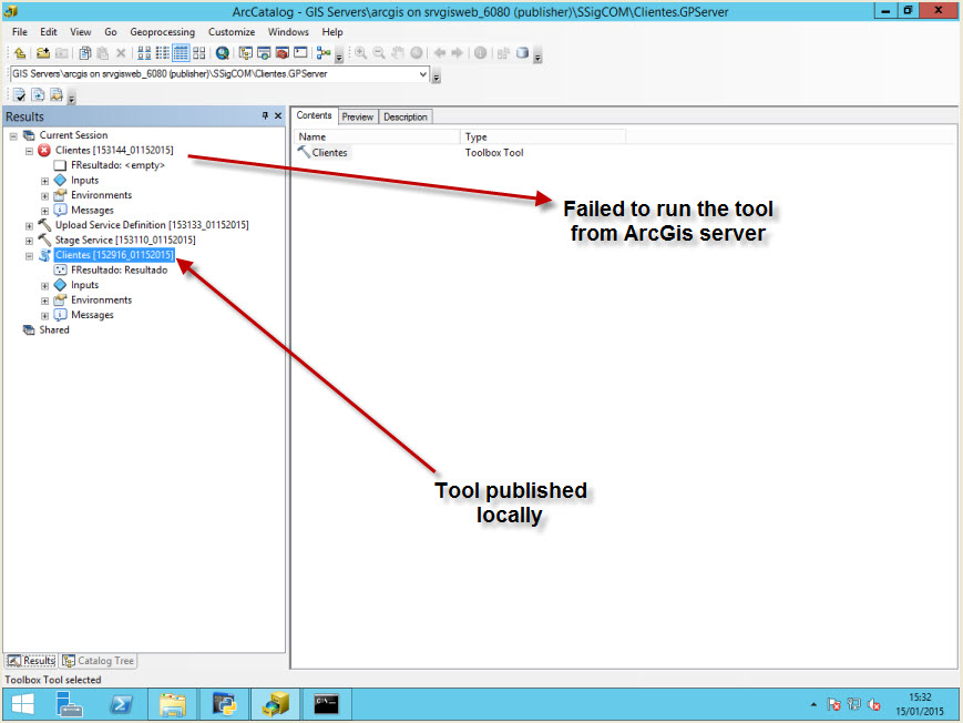

We check the DSN connection and it works, I could query the data from Excel, including the tool can be run locally from ArcCatlog and allows me to issue you ArcGis Server as you can see in the attached image, the problem I think is that ArcGIS Server not recognizes the pyodbc library.
Thanks for your feedback
