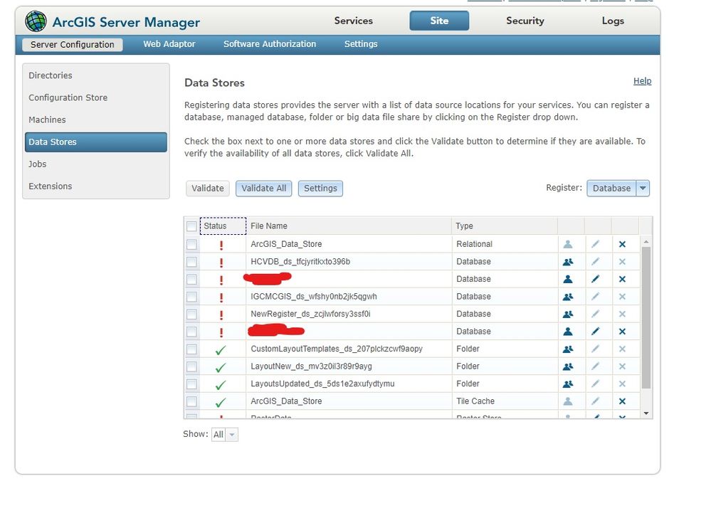

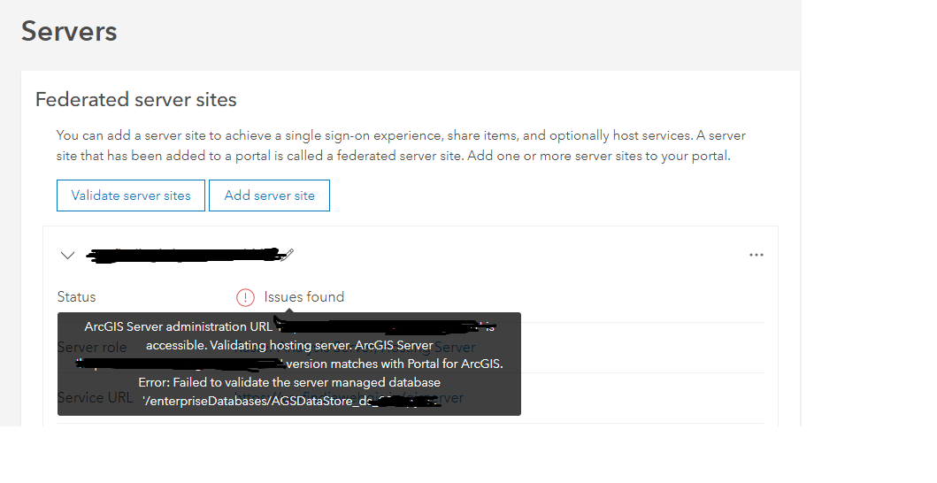

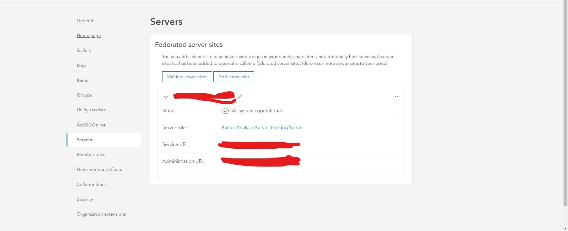

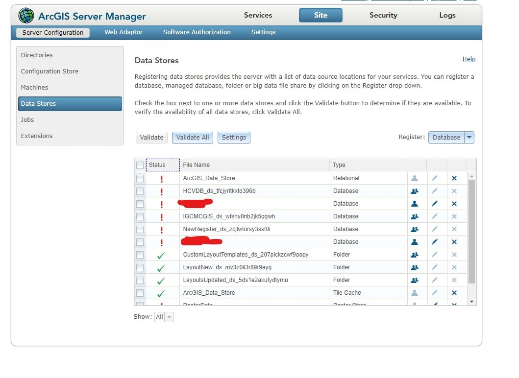

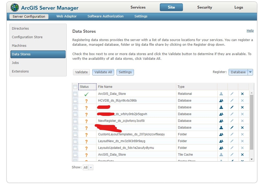

We are facing an intermittent issue all of a sudden where ArcGIS Data Store is sometimes validating with Portal & Server and sometimes not. I am not really sure what exactly is causing this behavior. Am attaching screenshots for reference purpose. Although tile cache data store does get validated.

Observations:
  • New hosted services are not getting published though, existing hosted services are loading in map viewer with attributes as well as geometry (not sure if its an expected behavior given data store is not getting validated).
  • Not sure if it's related to this however, have noticed that it is taking time for server manager, portal home to load.

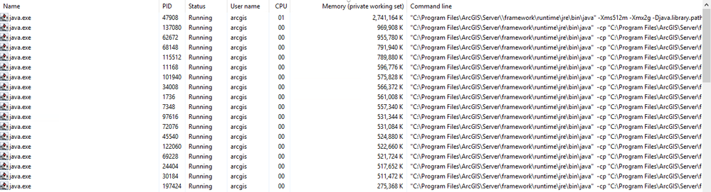

One more thing that I noticed today is  after I stop the services of Server, Portal & DataStore there are still certain java processes that are running in the task manager. Am not sure if this is an expected behavior and could this be the cause of DataStore not validating. Moreover, if this is not an expected behavior should I go ahead and end these tasks manually.
Attaching a screenshot for reference.
