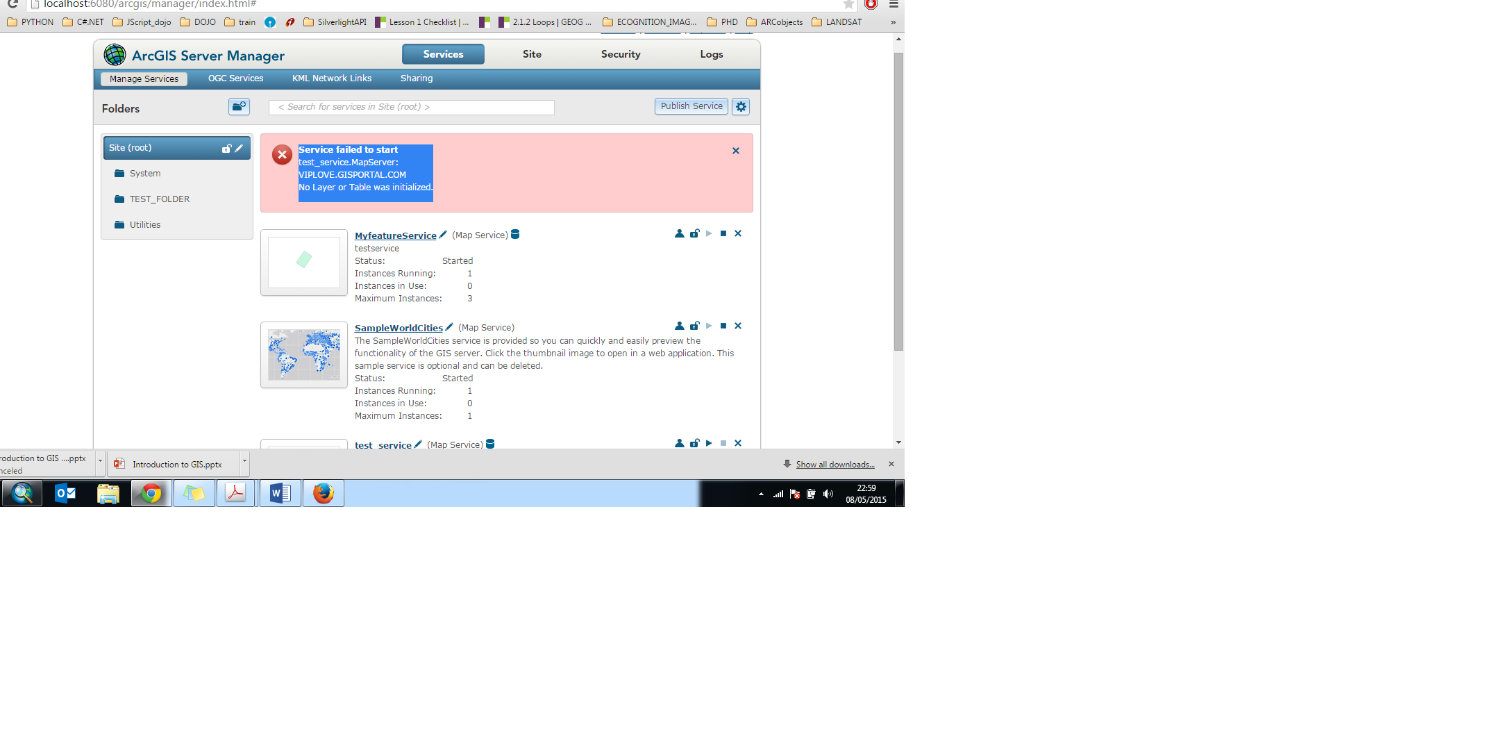

The followoing error message is giving after publishing the services to the server. am attaching the error below. kindly anyone provide the solution for it.
Service failed to start test_service.MapServer:
VIPLOVE.GISPORTAL.COM

Hi Viplaw,
What capabilities have you enabled in the service while publishing? And what warnings did you see while analyzing the services in Service Editor?

Hi jayantha
I have enable feature access in the service editor while publishing the services ...but today morning it started properly without giving any error message ..
Later sometime that published service is not starting

Hi Viplaw,
What database are you working on?
Have you registered the database with ArcGIS for Server?

Hi jayantha
I registered the DB n am using Postgres ..!this error is occurring when I restart the services .

Try the following steps:
In ArcCatalog,
1. Right-click on the postgres database connection
2. Choose Administration > Permissions
3. Pick the Server\arcgis account and give it 'Read Only' permissions.4. Try restarting the service.

Hi jayantha
I have tried that activity also even though it's showing that "services stopping" as service status .

DavidRunneals2
Re-validate your datastores and try restarting
gisserver.gis/manager/site.html > Data Stores > Validate All
