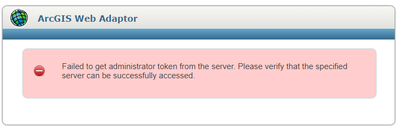

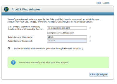

I am trying to configure the server Web Adaptor but I get this error shown in the pictures.

Assuming you are attempting to configure a Web Adaptor for an ArcGIS Server (you appear to already have a "portal" webadaptor configured)
Is "admin" the "Primary Site Administrator" account that was used when creating the ArcGIS Server site?
You will not be able to use a Portal user for this dialog. The WA is attempting to access the Server's token service and this will only work for a built-in account - most likely the Primary Site Administrator account (not the windows service account)
pkaniouras
I think I am using the proper admin user, but could you please tell me how to check that?

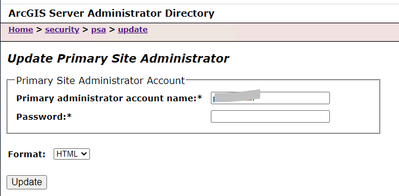

If you go to the server admin page
you should be able to see the name of the Primary Site administrator (PSA)
(dont apply any change)

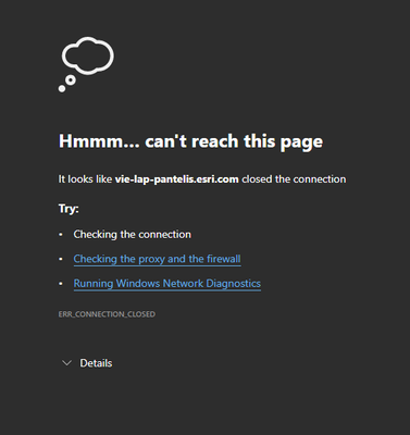

When I try to visit https://vie-lap-pantelis.esri.com:6443/arcgis/admin I receive the following:
DavidHoy
sorry about slow response - I was away from work for a few days.
Looks like Server is not even running - did you check the windows service?
Can you reach https://vie-lap-pantelis.esri.com:6443/manager ?
or https://vie-lap-pantelis.esri.com:6443/arcgis/rest/services ?
pkaniouras
Neither link works.
