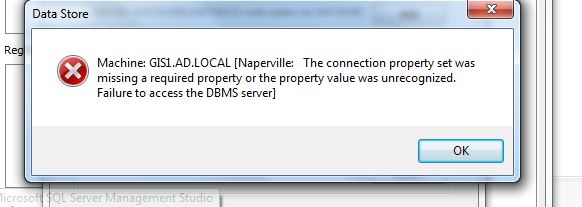

HI,
I'm trying to register a database sql server 2012 that is in another VM. My bank is 64-bit, the OS on both machines is 64-bit, only Arcgis is 32.
I already installed the client on the machine that is my GIS Server, but nothing works. As the OS is 64 I can never install the 32 client obviously.
I have already tried setting up ODBC 64 bit, but there is also connection failure.
can anybody help me?
Thank´s

It sounds like you are trying to register this database with ArcGIS Server when you are publishing from ArcMap. But what happens if you try to register it from Server Manager? Same failure?
https://enterprise.arcgis.com/en/server/10.5/publish-services/windows/registering-your-data-with-arc...
SoratoSouza_e_Silva
Hi Jonathan,
The same failure happen unfortunately!
FAILED TO ACCESS THE DBMS
Can help me?

Andre,
These errors mean that ArcGIS cannot communicate with your database.
What happens if you ping your database machine from your ArcGIS Server machine? Can they communicate? Can you telnet over the default SQL Server port (1433)?
It may be beneficial to open a support case on this as there is only so much we can do here.

Can you show more of the connection dialog when you are creating the connection and not just the error?
As Jonathan Farmer‌ noted, check for connection between the two systems via ping and telnet.  Check the ping for both IP and FQDN.
Do you have a firewall between the two systems or could they be running of different subnets/vlans?
Is port 1433 open and is this the port the SQL server is running you are trying to connect to?  Especially if not running on the default version.

Both firewalls are turned off, ping verified between ok! But only by IP, because no DNS configured. The 1433 port is on in database,..I do not know what to do anymore!!

As you do not have DNS enabled, have you tried to connect using the IP address of the server rather then the server name?
SoratoSouza_e_Silva
YES! Correct! By IP work very well. The communication is open.
