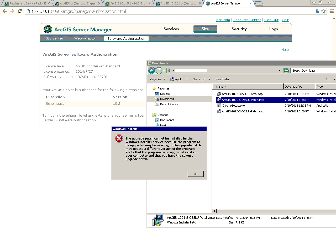

I am going to update the ArcGIS 10.2 server to 10.2.2 because ArcGIS 10.2.2 for Desktop require me to run the update before installing it. I downloaded the patches from here, and then while I run the update pack, it return this error message. Any help would be appreciated.

Not normally my area of interest, but looking at your screen clip, if you are on Server 10.2 you appear to be trying to install the patch for a 10.2.1 install. Does the 10.2 version of the patch install?

This isn't the patchset that upgrades 10.2.0 to 10.2.2, it's a security patch that must be applied
to the correct ArcGIS Server release.
I've only done full installs with Linux at 10.2.2, but my understanding is that the Windows
installer should be able to patch 10.2.0 to 10.2.2 in-situ (without uninstall, though that
remains an option).
