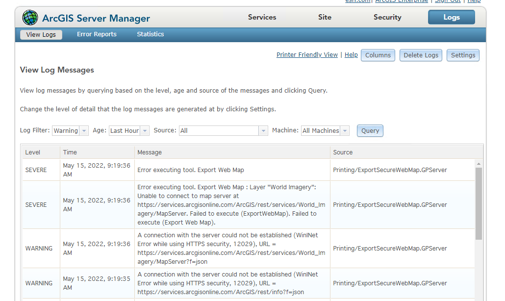

Issue 1: FeatureLayer, MapImageLayer, and GraphicsLayer are displayed on the map with ArcGIS Online basemap imagery as the basemap. When executing the print, it gives the error: Unable to complete the operation (400). Whenever I exchange the imagery with another basemap, like the Light Gray Canvas, the service generates a map. After inspecting the Server Log, I cannot connect to the ArcGIS Online imagery service due to an invalid certificate error, as seen in the image below.

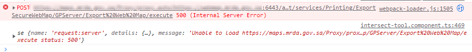

Issue 2: There is a result graphics layer where I add features intersecting with the users' input feature. The print functionality works whenever the result has a few features added to the layer. But when there are many intersecting features in the result layer, the print function gives a 500 (Internal Server Error), as seen in the image below.
If I hide the results layer, the print functionality works again, so it seems like there is a problem with the result layer, but I am not sure what it is. Is there a limit to the number of features the print function can print?

for the first issue, this what I'd recommend you to do:
  • log on to the server machine (that is hosting the print service) as the ArcGIS SOC user
  • open a web browser
  • try to access services from https://services.arcgisonline.com/ArcGIS/rest/services without it prompting you accept some certificates.
  • if it asks for certificates to accept or you can't access for some reasons, you need to check with your network/system admin to resolve this from your side.
    • please note that the 'Light gray' basemap is a 'vector tile service' where as World_Imagery is a cached map service. And they live in two different locations.
on the 2nd one:
- do you have any proxy server in between your webapp and the print service?
one thing you can do is this:
  • open your browser's Developer Tools and then switch to Network tab,
  • click print button from your web app
  • in the Network tab, look for the request made to the print service
  • look for the value for WebMap_as_JSON paramter... which should be a pretty large json string.
  • browse to your print service REST end point
  • copy/paste the WebMap_as_JSON string in there
  • execute it and see if it works
  • if it works, that means there must the some kind of middleware such as proxy etc. is causing the issue
  • if it does NOT work, please contact Esri Support with that json and they should be able to log a bug for that (if that turns out to be a bug) and we will look into this.

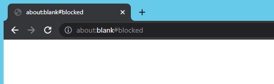

Getting a blank screen after pressing the Execute Task (GET) button, as shown below.
I also inspected the developer tool, and it is blank. What does this infer?
