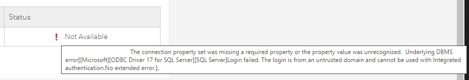

Now, a few of the datastores on our portal are no long accessible.  I am getting the below error from my hosting server.

I did run this utility and it says it ran successfully.  It did not, however, fix the error message we are getting with certain datastores now.
