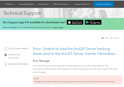

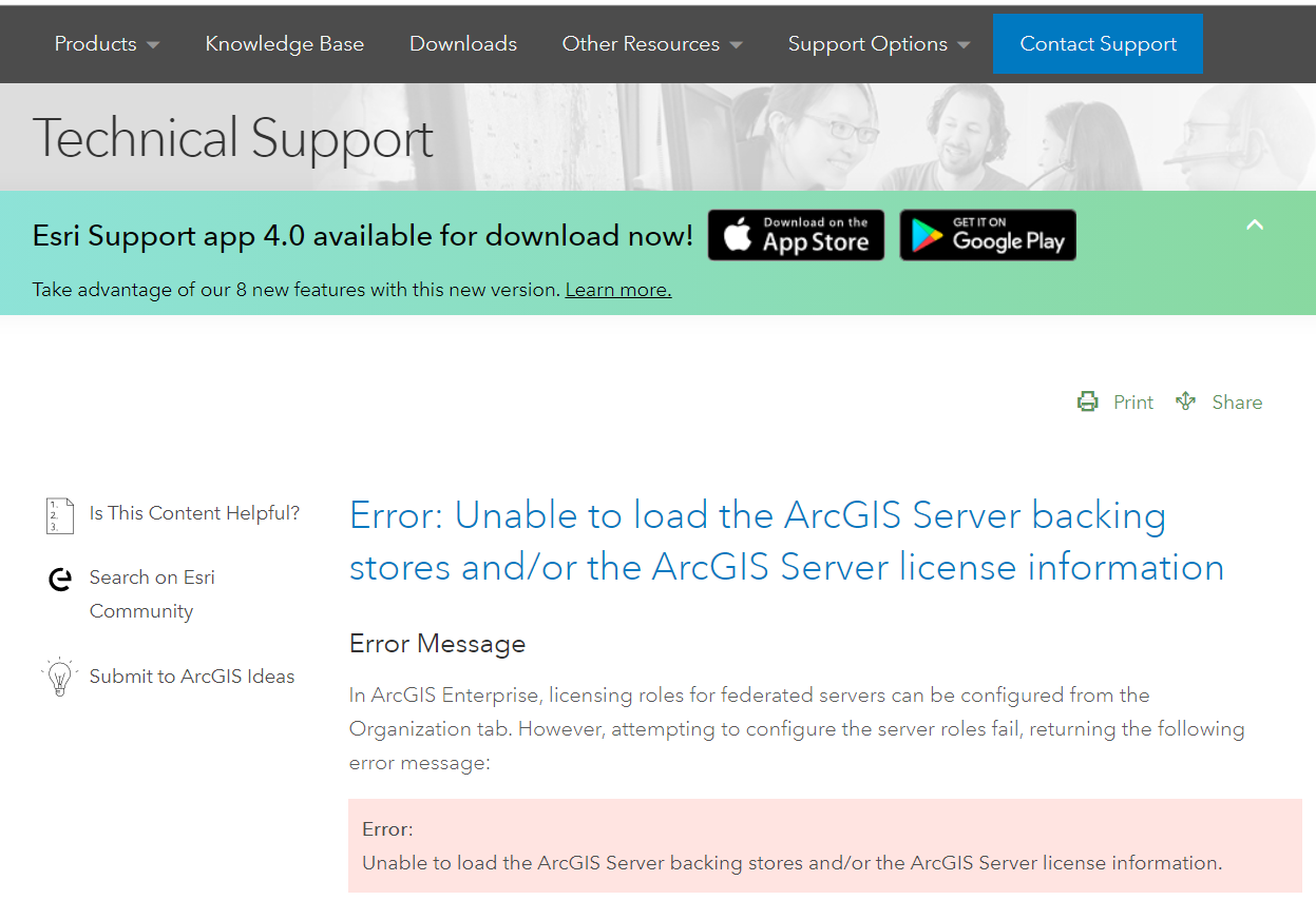

It's already in Technical document, but I can't solve the problem.
https://support.esri.com/en/technical-article/000025762
In the case of the above document, it says that it is applicable to version 10.9, and it seems that some of it occurs when version 10.9 is updated. I upgraded 3 Enterprises to version 10.9, and I got this error in two places.

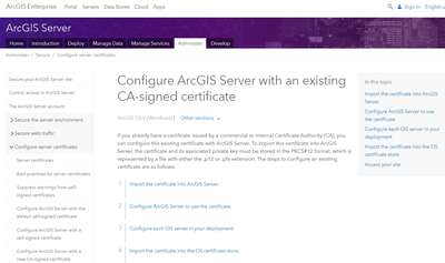

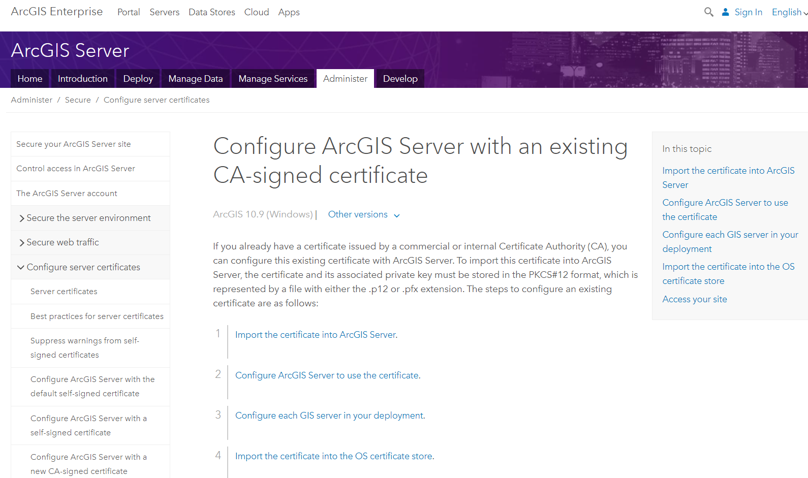

When I configure ArcGIS Server with an CA-signed certificate, I refer to the following document.
https://enterprise.arcgis.com/en/server/latest/administer/windows/configuring-https-using-an-existin...
