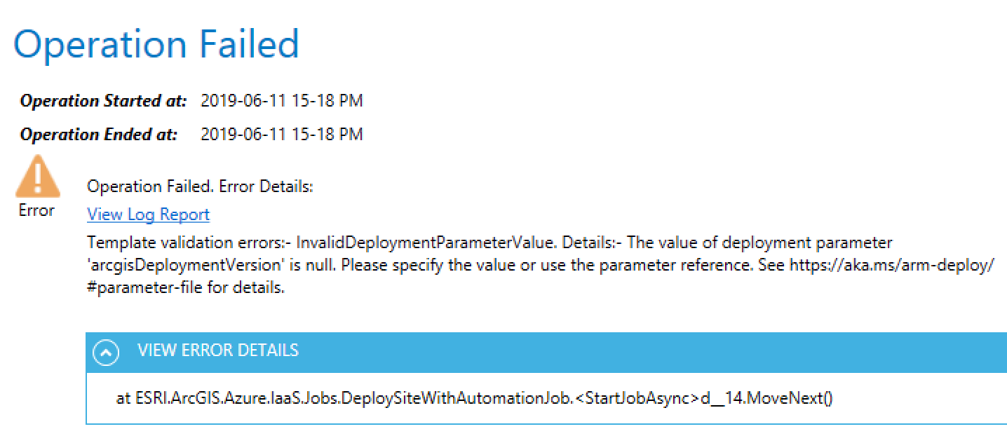

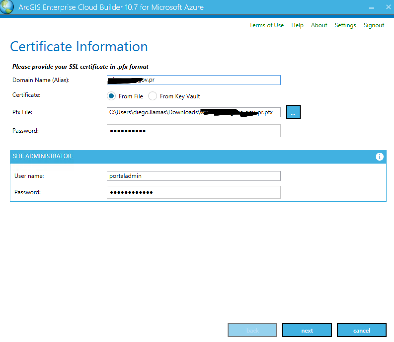

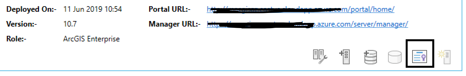

I did a 10.7 enterprise base deployment using Azure Cloud Builder. I did a cname in Godaddy for the certificate assigning the external URL that is going to be used for the portal. So I click the option assign a certificate.
I select  de domain name, the pfx file and password, and the portaladmin user.
Then I select the storage Account. Then click finish to start the process.
And then This error "The value of the deployment parameter 'arcgisDeploymentVersion' is null' please specify..." but in the steps above there is no field to specify the version.
Deploy version
Any idea what could be wrong?

Hello, i believe this is a bug which has already been logged regarding this in 10.7 (and 10.6.1) Cloud Builder.
Can you attempt to check the "Prefix Azure Resource Manager (ARM) Resource names with" box.

HEllo Travis,
When I did the deploy, i did check the ARM box with a kv prefix. Do you recommend to delete machine and deploy it again?
