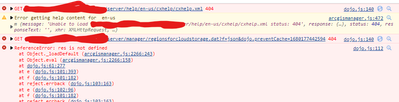

Hi Diane,
Are you by any chance getting warnings in Chrome Dev tools when you log into server manager saying that a cxhelp.xml file can't be found?
I've checked my server configuration and the help files are at the following location:
C:\Program Files\ArcGIS\Server\help\server_help\en\cxhelp.xml  not help/en-us/cxhelp.html
I''m wondering if this is where the : "Error parsing help links: Premature end of file." error is coming from ?

In regards to the to /help/en-us/cxhelp/cxhelp.xml 404 error. This is a know limitation and it is based on your browser's locale. When you open Server manager for example, it loads based on your browser's locale which in this case is English/United States (en-us). If that returns a 404, then it will try again with English (en) (/help/en/cxhelp/cxhelp.xml). You should see a successful request to "en" as opposed to "en-us" later on in your dev tools (basically this 404 is expected depending on your browser's locale and can be ignored).

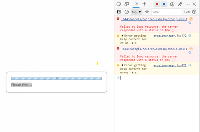

Yogesh, were you ever able to resolve the issue of accessing the server manager once federated to portal? We are experiencing similar issues with our 10.9.1 environment.
To briefly summarize our issue, after federating our ArcGIS Server (10.9.1) with our on-premise enterprise portal we are unable to access the ArcGIS Server Manager, or Secure REST services.
If I try to login to ArcGIS Server Manager I am presented with the server login screen but am never able to authenticate (sits at Please wait....)
If I try to login to the REST endpoint, the URL I can see in the browser developer tools is something like https://servername/arcgis/login?ReturnUrl=https://servername/arcgis/rest/services, which seems to just loop back to itself briefly..
