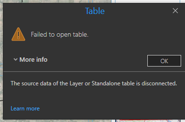

Some employees at my org are also getting this error when trying to open an APRX with a layer joined to an excel table on our fileshare server. It works for some employees and not for others (all have access to the file). Running Pro 3.1 and 3.3.
We get "Failed to open table - The source data of the Layer or Standalone table is disconnected.

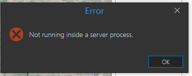

If I try to preview the sheet from the Catalog Pane, I get the error "Not running inside a server process."

JoeBryant1
To resolve the issue, I had our engineers move the complex charts and graphs they were making in separate sheets in the Excel file to another workbook that calls the data from this workbook. Once I cleared Pro's cache and reduced the Excel workbook down to a single sheet, it consistently opened.
